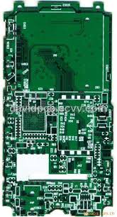

11-25-2010, 22:37 | #70 (permalink) |
No Life Poster Join Date: Feb 2008 Location: Bosnia
Posts: 865
Member: 698071 Status: Offline Sonork: 100.1622915 Thanks Meter: 283 | PCB motherboard which is not clearly ... here's an example of a PCB http://t2.gstatic.com/images?q=tbn:A...ScAKQbETElQPdk |
