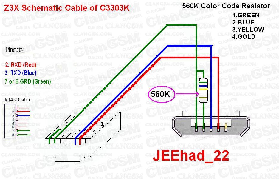

uart cable

[IMG]http://www.************/forum/uploads/monthly_10_2010/post-597-1286402341.jpg[/IMG]

Where can i get 560k . Can you show me on any phone plzzzzzzzzzzzzzzzzzzz
will it work on lg c105
thanks for reply
