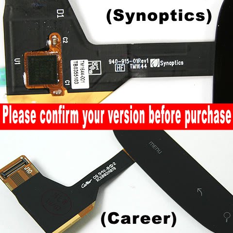

Hi,
On reading a Few posts I have discovered the following..
My HTC Wildfire needs a Touchscreen Replacement.
There seems to be two types of touch screens for the HTC WildFire A3333,
One from Synoptics and the other from career or carter(Not sure about the second name). Both with IC. I disassembled my Wildfire and found that I have the Second type. Career or Carter.
I need the following info
Will Synoptics work for me?
Should i change or mod firmware if i do so?

only 2 types digitizer
Make sure your digitizer with ic or without ic?...only 2 type digitizer in wildfire .
with ic type not sutable for without ic one also without ic one not sutable for with ic one. rev: ver dosent matter for worning..just replace it..no need to firmware update..

Okay.. If i donot have IC, i can replace it with synoptics or career without IC.
Is that correct?

you will get only carrer with out ic
Is that correct?
with out ic one is carrer digitizer..so use that one...
with ic one is only synoptics digitizer

i have same problem i purchas digitalizer without Ic sensor

I ordered one expecting to get one in 5 days or less. Will post back the results. Thanks a lot..
