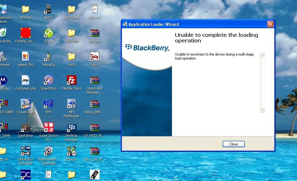

Huh!! what you think i m not search before post?There is no good thread (solution) about this problem.Anyway i already did everything with software and every time i got one error.You instruct here
when application loder come this massage like on pic > wait for device initialize , then insert battery on blackberry , dont touch/disconnect cable
I m also trying to did it.But no luck.
error like this

Yes dear i m flash the phone with same vendor.its comes from usa t mobile and i m download from t mobile support site.
