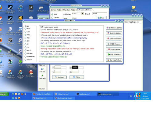

Companions as I always say that this wonderful box decpeciona GPG DRAGON because I will comment this tedious outfit always bring me to unlock and user code, then I started thinking and said that dragon is compatible with software from smart-clip , that make almost the vast majority of Chinese phones and varied so I said I will try something and it's what I did to connect this telefonito, that I know with inifnity must be manufactured or bought the cable made who believe what I thought I turned now I share with you I think I'll do the first run this process will be a good BOOM. only here to support mobile here are the steps that I made:
1-first connect the phone to the GPG DRAGON with the point P-10C
2-I opened the program DRAGON GPGDragon Freeware Tool2 GPG can be found on this forum
3-Definitions, what kind of processor was in my case MTK image

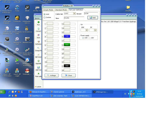

4-I defined 2 times as I did, I gave the sequence to define the program so my GPG DRAGON I recognized in my case gave me the second definition was RX = 18, TX, GND = 16 = 23. then defined the point where said wire tab: P-10C, where it says NEW wrote CL261 Brand wrote and where it says 1234, ready, set up my GPG DRAGON image here:

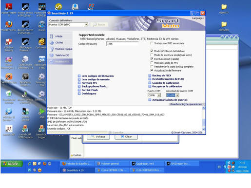

5-Connect my smart-clip key and opened the software SmartMoto 4.29, select the PC com port, after that MTK models then Select the com in my case was 6 the highest veleociodad 921600 and the first will remove the code user as I show in the pictures:
[URL=http://www.mediafire.com/view/?6462hhde1b6so17][IMG]http://www.mediafire.com/conv/0239f942c77cd6e4b3590631c271731123c5ef7f5aa56784f5 d059e6a4a2294d4g.jpg[/IM

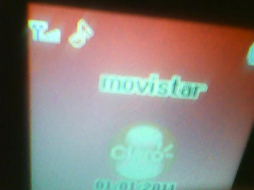

6-then make unlock procedure and guess was 100% read me NCK code testeiado for myself:
[URL=http://www.mediafire.com/view/?bqf1jc5ycxs82ep][IMG]http://www.mediafire.com/conv/eab6b61880bb99423941
I hope we aportanto more and more that other colleagues of my humble contributions here at only GSM-Forum will be the first around here a picture of the cell and to sign and another sim card from another company:
