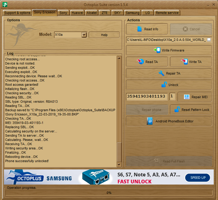

Thumbs up Sony Ericsson X10a_{Network Lock}_successfully removed...
To avoid the following error during the unlocking process
it's mandatory to write the generic firmware provided at the support area.
Device serial number: CB511HZ69X
Device status: ACTIVE
Kernel version: 2.6.29-rel
Firmware version: R2BA023
Kernel version not supported yet.
Please, contact to support
Full logs of the operation/
Flashing Process/
Platform: SE Qualcomm
Selected model: X10a
Opening "X10a_2.0.A.0.504_WORLD_GENERIC.oct"...OK
Please, reconnect battery, hold "back" key and connect USB cable...OK
Reading info...
Chipset: S1 QSD8250
IMEI: 359419-03-401193-1
MSN: CB511HZ69X
Sending loader...OK
Writing Firmware...
Writing AMSS...OK
Writing AMSS_FS...OK
Writing CACHE...OK
Writing DSP1...OK
Writing FOTA0...OK
Writing FOTA1...OK
Writing KERNEL...OK
Writing SYSTEM...OK
Writing USERDATA...OK
Shutting down...OK
Auto-Root and unlocking process/
Connecting to server...OK
Octopus smart card is present.
Checking smart card...OK
Smart card activations: LG, Samsung, SE Unlimited, Medusa
Username: Default_user
Authorizing...OK
Checking balance...OK
Your balance: 0 credits.
To unlock X10a you need to have 0 credits.
Disconnect USB cable and power on the phone. Select menu "Settings"->"Applications"->"Development"->"Enable USB debugging" and connect USB cable...OK
Firmware version: 2.0.A.0.504
Kernel version is supported
Checking root access...
Device is not rooted.
Sending exploit...OK
Executing exploit...OK
Reconnecting device. Please wait...OK
Checking root access...OK
Root access garanted!
Initializing flash...OK
Checking security...OK
Reading SBL...OK
SBL type: Original, version: R8A013
Reading TA...OK
Backup saved to "C:\Program Files (x86)\Octoplus\Octoplus_Suite\BACKUP\Sony Ericsson_X10a_22-03-2019_19-35-00.BKP"
Checking TA...OK
Replacing SBL...OK
Calculating security on the server...
Sending TA to server...OK
Calculating. Please, wait...OK
Receiving TA...OK
Writing security area...OK
Finalizing...OK
Rebooting device...OK
Phone successfully unlocked!
