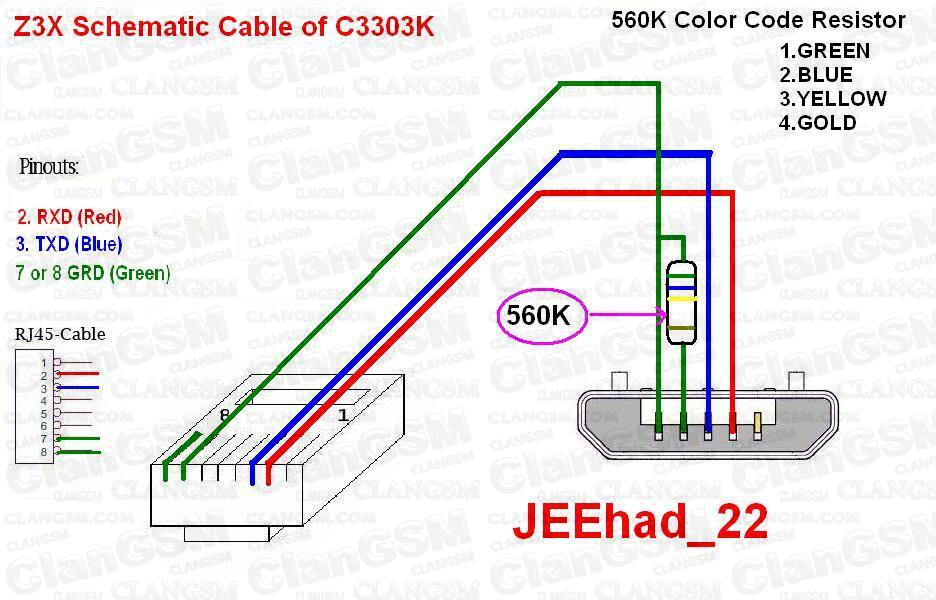

Thanks for the previous answer, I solved it. The problem was due to conflicts with sansumg kies software, I solved uninstalling kies sanmsumg.
But now another problem.
This is the report to repair my imei:
Prepairing ... OK
Device Found!
Informations Phone Reading ...
Model: GT-I9300
Android Version: 4.1.2
PDA Version: I9300XXELLC
CS Version: I9300PHEELL3
Phone Version: I9300XXELLA
IMEI: NULL
Disabling Security ... Done!
Rebooting ... OK!
Remove USB Cable Now then Insert Micro UART cable to Phone to Continue ..
Delay 40 Seconds ...
Searching for phone on COM12 ... Fail!
Phone not found!
Operation Completed
Operation Time: 00:03:30
The Micro UART connector has two switches.
The first indicates NG / LG / SAM: SAM I have selected
The second indicates 510k/300k/130k: I have selected 300k
What is the right combination for the i9300?
I tried all combinations and does not work.
Do I have to buy another cable?

uart i9300
It is not possible to repair the imei of i9300 with this cable.
I believe that the cable is necessary uart c3300k to repair the imei.
I have download the Internet schemes and am going to make the cable, only I need a resistance of 560k, this evening I prove it and I will keep you informed.
There is someone who has managed to repair the imei of i9300 with this box?
Please, I need that they confirm to me if the cable to connect the uart correctly is c3300k.
Forgive my English, I am Spanish
Old 02-09-2013, 11:26   #104 (permalink)
Asansam dongle's Avatar
Location: Iran
Posts: 3,063
Member: 1707100
Sonork: 1590245/1587178
Thanks: 516
Thanked 9,112 Times in 815 Posts
this is download mode cable only and dont work for repair
you must use this cable
