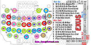

Red face Blackberry 8520 All keypaid no work pleas help
My blackberry 8520 all key no work.This set no water damage pleas help........

try this
Just clean key section & all side keys on board. Main thing is that change trackpad.
I have tested it on many phone.
Try please reply.

clean the all contacts of the keypad and change the trackpad it will work 100%

after cleaning pcb panel.change all the side keys your problem will be solve.dont forget to click thanks

What steps have you done?
have you checked the resistance?

8520 keypad not work 100% tested
testing 100% work try it

remove this resistor
this resistor work only for protection
