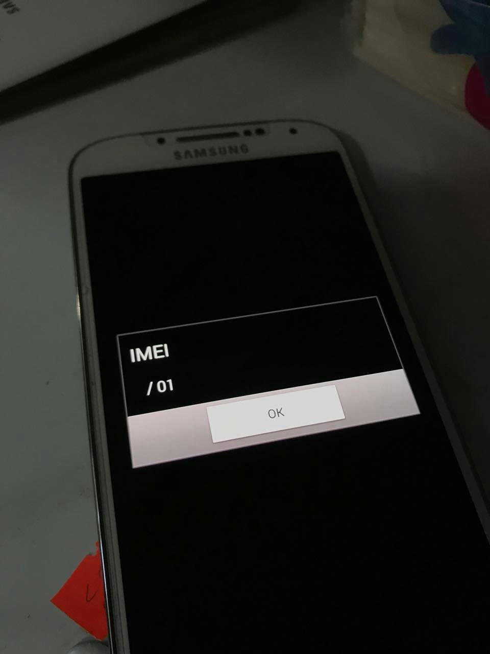

04-14-2017, 14:32 | #743 (permalink) |
No Life Poster Join Date: Mar 2015 Location: Islam Age: 35
Posts: 7,399
Member: 2371500 Status: Offline Thanks Meter: 5,801 | samsung sc 04e repair imei done hi imei was 01 simply root phone then CLEAR NVM(DO ALL BACK EFS ENVM) THEN BY RJ45 CABLE PRESS GEN SETTING REPAIR IMEI AND PRODUCT CODE |
