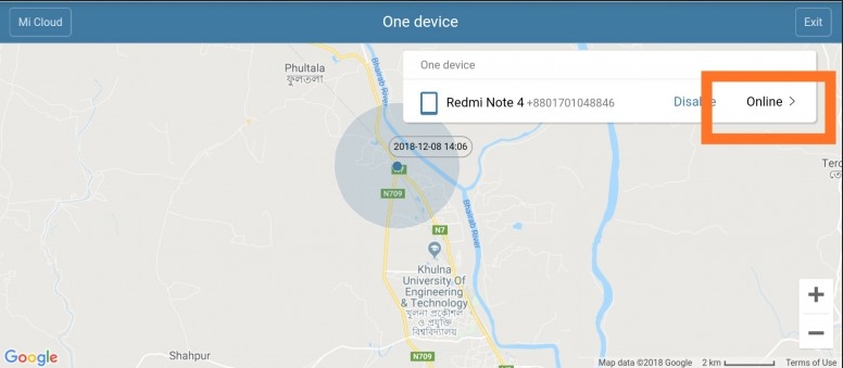

Dear User Now if Your Mobile have Find my Device is ON
then EDL / Download Can't work. Miracle Tool Can't Connect Mobile if Find my Device is ON
How to disable it
Disable (Off) Find My Device
Go to i.mi.com website> Go to your Mi Account> Click "Find device">
Choose your Phone on the right> Click three dots> Click
"Turning off Find device" (The pictures below show how to do this)
● Go to the MI Cloud website (Click here) and sign in to your MI account. (You need a computer or another smartphone.)
● Click Find Device on the homepage of MI Cloud.
● If you ever located your phone before, you should see the phone's approximate location on Google Maps. But, if this is the first time you use "Find Device" function, you will not see the map. I took my Xiaomi Redmi Note 4 as a test, you can see my device is online, what I can do is just click on it.
Just Disable it
