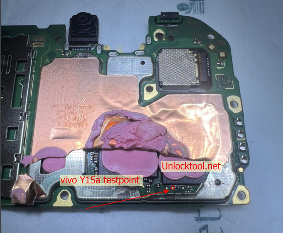

Originally Posted by ..:: SONY ::.. View Post
Use testpoint then unlock
Same result
Testpoint or not, same error
[BROM] ERASE FRP Phone must have battery inside!
Waiting for device... COM9 [PRELOADER:0E8D:2000]
Selected Model : Vivo Y15A, Y01 New Sec Patch
Code Name : PD2140F_New_Security
Operation : Erase FRP [7]
**Authenticating... OK
**Retrieving data... OK [477.54 KiB]
Handshaking... OK
Reading hardware info... OK
* Hardware : MT6765 [Helio G25|G35|P35] 0766 8A00 CA00 0000
* Security Config : SCB DAA
* MEID : 629713E84BA8199E2E2D40030A73ACBE
Analyzing... preloader_k65v1_64_bsp.bin [MT6765:15:2512] [Internal]
Sending Download-Agent... FAIL
Failed to send DA STAGE 1!
EPP : DA Features set mismatch! Status code : 0x7024
UNLOCKTOOL 2022.11.30.0
Elapsed time : 40 seconds
Any solution?
