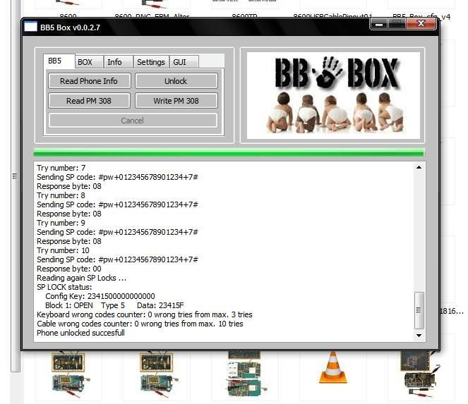

I'd tried to downgrade the version 5.50 to version 4.70 and try to unlock....
Connecting to BB5 Box ...
Searching for phone ...
Phone found on FBUS interface
Reading phone info ...
Type: RM-217
Version: V_04.70_24-01-07_RM-217_(c)_Nokia.
IMEI: 358649017668890
SP LOCK status:
Config Key: 2341500000000000
Block 1: CLOSED Type 5 Data: 23415F
Keyboard wrong codes counter: 0 wrong tries from max. 3 tries
Cable wrong codes counter: 10 wrong tries from max. 10 tries
Set Full Factory Defaults ...
Reset phone ...
Reset phone in TEST mode ...
Full Factory Defaults set OK
Create autobackup of PM 308
Reading PM Field 308 Subfield 1 with length 8192 bytes
Saving autobackup to file: RM-217_358649017668890_Locked_Keycnt_0_Fbuscnt_10__V_ 04.70_24-01-07_RM-217_(c)_Nokia..bin
Auto Write PM 308 procedure started
Searching for backup file with lowest FBUS count ...
Finded backup file: RM-217_358649017668890_Locked_Keycnt_0_Fbuscnt_0__V_0 4.70_24-01-07_RM-217_(c)_Nokia..bin
Writting PM Field 308 Subfield 1 with length 8192 bytes
Reset phone ...
PM Field 308 Subfield 1 written OK
Reading SP Locks after Auto Write PM 308 ...
SP LOCK status:
Cable wrong codes counter: 0 wrong tries from max. 10 tries
Checking if model/version is supported for unlock ...
Please connect testpoints
Testpoints connected OK
Keep Testpoints connected until unlock finish!
Unlocking phone ...
Try number: 1
Sending SP code: #pw+012345678901234+7#
Response byte: 08
Try number: 2
Response byte: 08
Try number: 3
Response byte: 08
Try number: 4
Response byte: 08
Try number: 5
Response byte: 08
Try number: 6
Response byte: 08
Try number: 7
Response byte: 08
Try number: 8
Response byte: 08
Try number: 9
Response byte: 08
Try number: 10
Response byte: 00
Reading again SP Locks ...
SP LOCK status:
Block 1: OPEN Type 5 Data: 23415F
Phone unlocked succesfull
Success unlock via BB5Box..Wow Nice gadget and nice update...thnx to Raskal, Manole and dani
BR,
DaWizard
