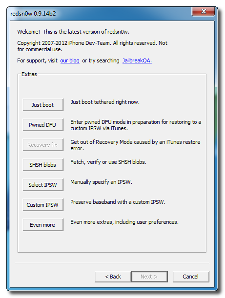

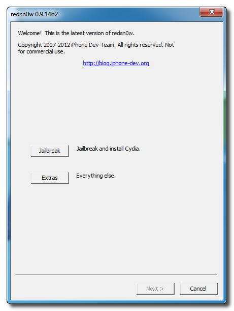

Once RedSn0w opens click the Extras button.
Choose Even More from the Extras menu.
Select DFU IPSW from the Even More menu.

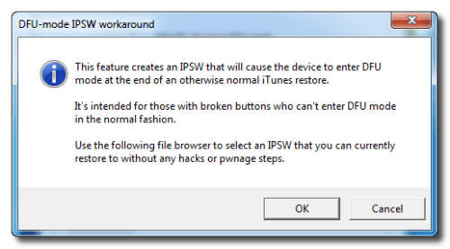

You will be instructed to select an IPSW that you can currently restore to without any hacks or pwnage steps. Click OK.
Select the ipsw firmware file you downloaded (4.2.1 3G) and click Open.

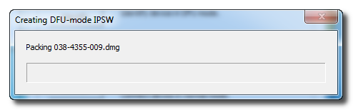

RedSn0w will now proceed to create a DFU Mode IPSW.
-You Should Find Created IPSW DFU Restore On Same Folder As Redsn0w
