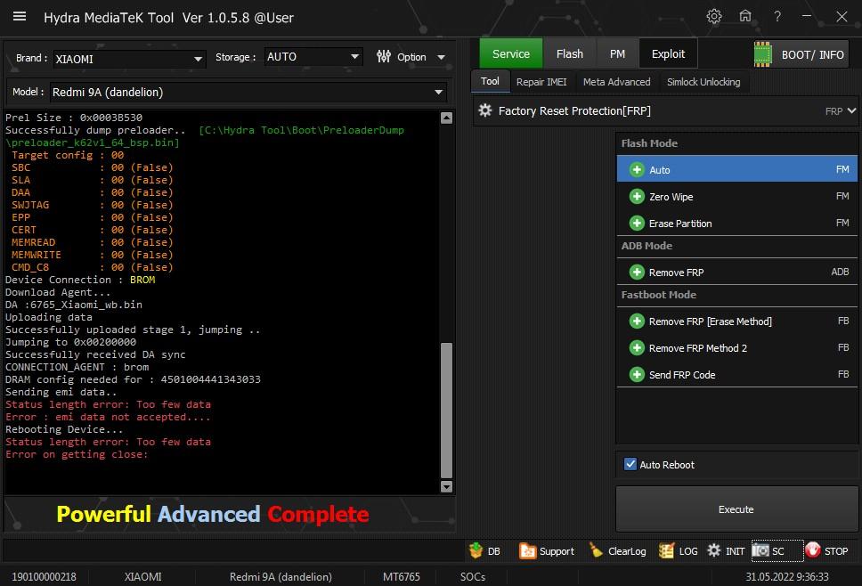

connect error Redmi 9A
Old 05-31-2022, 09:25   #45 (permalink)
Hydra Tool's Avatar
Join Date: Aug 2018
Location: Ukraine / Harkov
Posts: 2,044
Member: 2857401
Thanks Meter: 7,139
Hello,
Please Select Auto brand and Re-Try BOOTING to device,
Its relate with Download Agent issue, we are fixing it in next update.
Best Regards | Hydra Team
