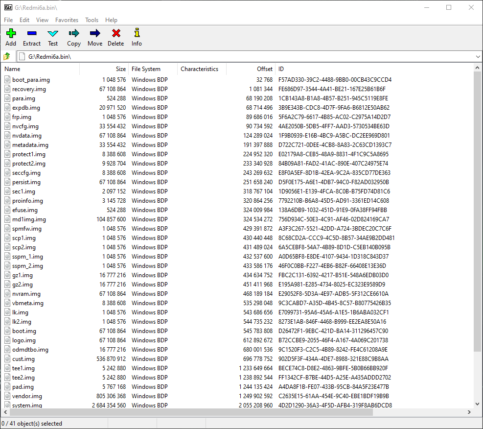

  • using this features you can read full dump from device (All Partitions and security)
  • gsd pro dump is user frindly , you can explore and extract all image file from gsd pro dump with 7zip or more
  • All Chipset is supported automatically w/o need preloader , da and more ...

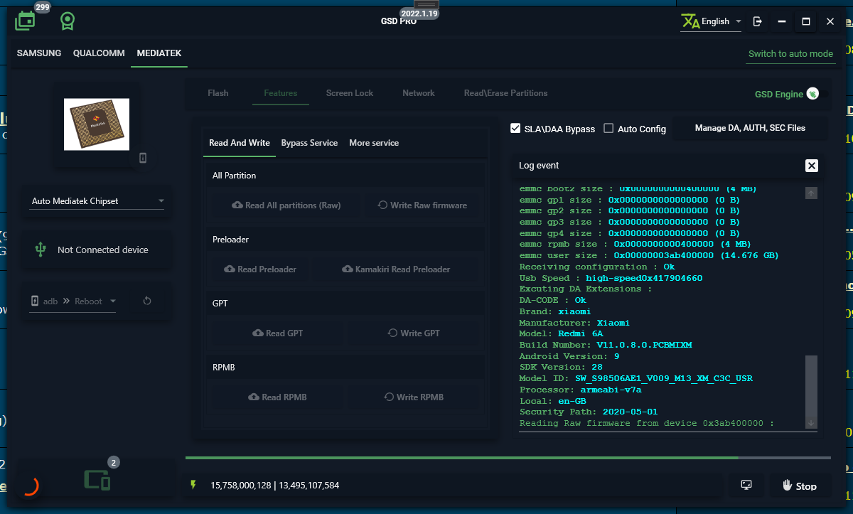

How to us :
  1. Open GSD Pro
  2. Goto » Mediatek » Features » Read And Write
  3. Click » Read All Partitions (Raw)
  4. turn off device ,hold boot key and connect to system

Receiving configuration : Ok
Usb Speed : high-speed0x417904660
Excuting DA Extensions :
DA-CODE : Ok
Brand: xiaomi
Manufacturer: Xiaomi
Model: Redmi 6A
Build Number: V11.0.8.0.PCBMIXM
Android Version: 9
SDK Version: 28
Model ID: SW_S98506AE1_V009_M13_XM_C3C_USR
Processor: armeabi-v7a
Local: en-GB
Security Path: 2020-05-01

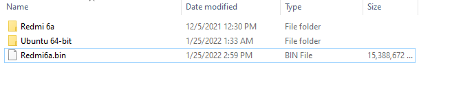

Reading Raw firmware from device 0x3ab400000 :Ok
elapsed Time for this operation:02:03:32.4718896
