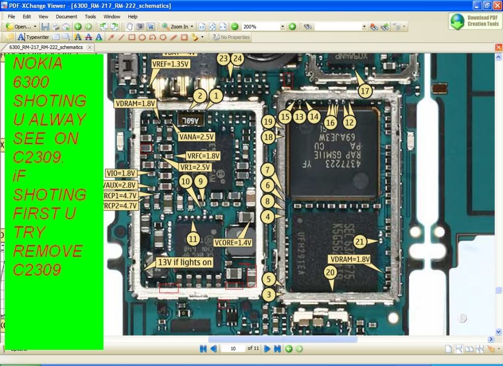

Old 02-15-2010, 13:27   #207 (permalink)
huong2's Avatar
Join Date: Aug 2009
Posts: 216
Member: 1105586
Thanks Meter: 112
The Following 8 Users Say Thank You to huong2 For This Useful Post:
