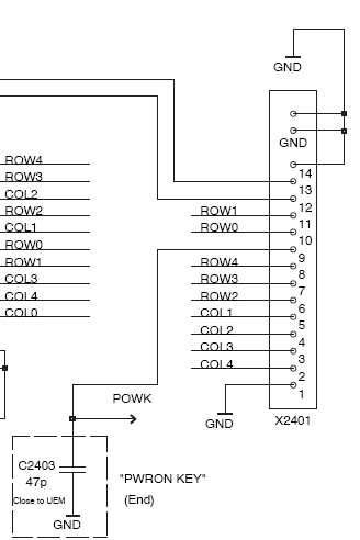

hi mate i have a problem nokia 2630 its normal water damage area near uem and keypad connector so i have clean this area !
then i have check set is not on but when plug the charging pin then show charging but not power on then i have rehot Uem but stile same keypad flux cabel is fine plz give me good solution i m waiting for good solution thx in advance !

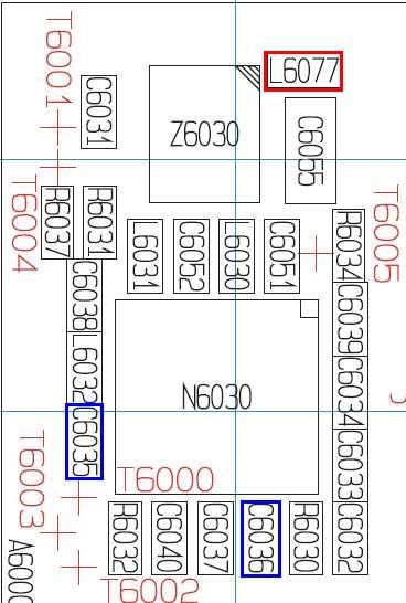

Hi.
I have 3500 that bluetooth dose not turn on,i flashed it but nothing happened,
What is the solution?
thanks,

Originally Posted by begginer View Post
Hi.
thanks,
Hi.
thanks,
BROTHER,
CHECK L6077-VBATT 3.6VOLT
R6030,C6035-VIO 1.8VOLT
The Following User Says Thank You to SHIJILFONOTLY For This Useful Post:
