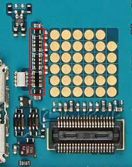

5200 blue display
sir 5200 with blue display
incoming out going working..
ihv change Flex cable (strip)
ihv change Display,
ihv Change Front Board... but.. still problem same plzz help
ihv change Display,
brother change red marked resister
post result

Sir Ihv attched A pictur ... marked Print is missing plzz helpp
brother here the missing print ways
post result
