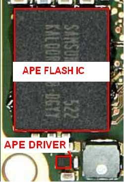

Posts: 6,598
Member: 351924
Thanks Meter: 12,466
Originally Posted by Freshbol View Post
Where placed this APE Driver and APR flash IC ?
here this picture
The Following 7 Users Say Thank You to SHIJILFONOTLY For This Useful Post:

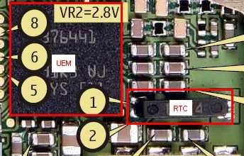

Old 11-04-2008, 05:04   #117 (permalink)
Join Date: Jan 2006
Posts: 553
Member: 219015
Thanks Meter: 42
Originally Posted by SHIJILFONOTLY View Post
brother u mean with battery phone not power on?
Yes.
insert battery then insert charger,now phone show charging?
No
then check on/off switch volt
How I can check this? Share it...
on/off volt missing check this picture
I check it, but is OK.
The Following 4 Users Say Thank You to Freshbol For This Useful Post:
Old 11-04-2008, 05:42   #118 (permalink)
SHIJILFONOTLY's Avatar
Location: Kerala-India
Posts: 6,598
Member: 351924
brother Freshbol,
did u change second loacl crystal or RTC?
try to change 2 parts then check it
i like that ur reply methode
post result

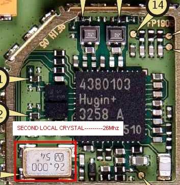

Old 11-04-2008, 08:11   #119 (permalink)
Join Date: Jan 2006
Posts: 553
Member: 219015
Thanks Meter: 42
brother Freshbol,
post result
Hi, my friend!
I can't find this components from schematic.
How marked this components in schematic?
The Following User Says Thank You to Freshbol For This Useful Post:
Old 11-04-2008, 09:26   #120 (permalink)
Posts: 6,598
Member: 351924
Hi, my friend!
BROTHER HERE THAT PICTURE
POST RESULT
