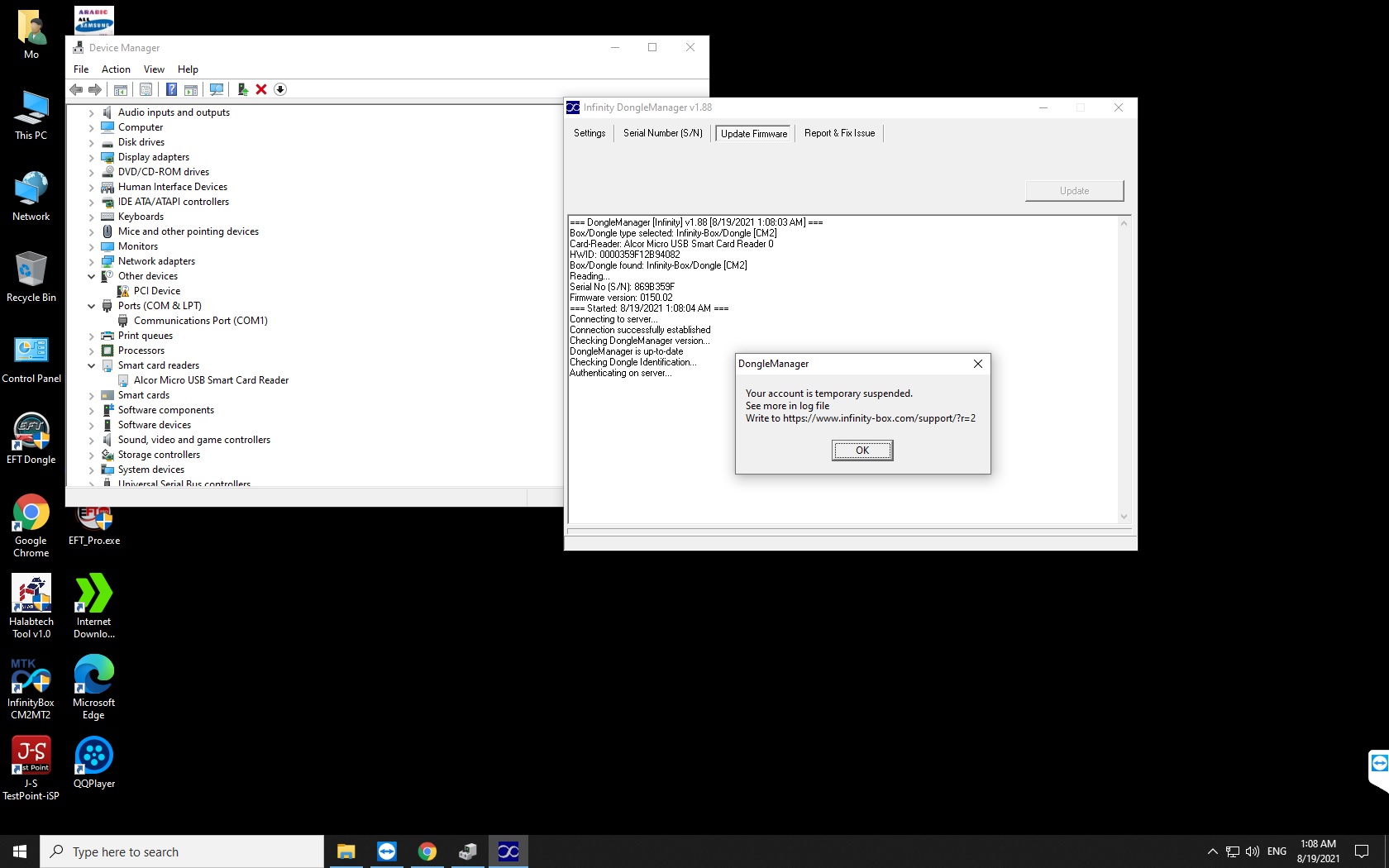

i have this issue
Box/Dongle type selected: Infinity-Box/Dongle [CM2]
Username: 00869B359F
==> Scan F:\الشغل\بوكسات\cm2\DongleManager for report.log
==> Scan c:\InfinityBox for report.log
==> Scan c:\Program Files for report.log
==> Scan c:\Program Files (x86) for report.log
Found files: 0
==> Scan F:\الشغل\بوكسات\cm2\DongleManager for *.ibin.log
==> Scan c:\InfinityBox for *.ibin.log
==> Scan c:\Program Files for *.ibin.log
==> Scan c:\Program Files (x86) for *.ibin.log
Found files: 0
==> Scan F:\الشغل\بوكسات\cm2\DongleManager for fault.bin
==> Scan c:\InfinityBox for fault.bin
==> Scan c:\Program Files for fault.bin
==> Scan c:\Program Files (x86) for fault.bin
Found files: 0
No reports found
Old 08-19-2021, 08:11   #24 (permalink)
Join Date: Mar 2005
Location: infinity-box
Posts: 38,672
Member: 130995
Thanks Meter: 35,230
@amrMHF
insert card into Alcor Micro USB Smart Card Reader and update now ONCE

error when listing readers
smartcard api error 2148532270
cannot find smart card reader
This error means you have no dongle connected to PC.
Also it may be Card-Reader or Smart-Card hardwar fault.
Try to insert smart-card to another card-reader (dongle).
What is the result?
