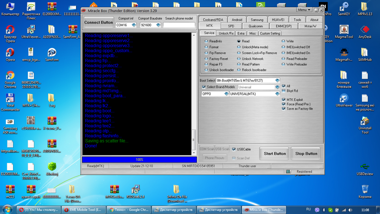

Oppo Reno2 CPH1951 read firmware miracle thunder (Success)
[IMG][/url][/IMG]
1. Power Off Phone , Remove Battery, Insert Battery Back
2. Insert USB cable. In some cases Required Hold BootKey
3. Use Miracle Boot Key In cases Boot key not Find
4. Battery Should be Charged more then 50%
Waiting for USB Port...
Set MediaTek USB Port_V1632 (COM16)
Connecting to Phone,Wait..
Connected to Phone.
CPU: MT6779 SW:0000 Ver: CA01
Enter first mode...
Success!
Preparing data..
Downloading Boot8 ...
Flash Name: KM8V7001JM-B810
EMMC Size: 0x001DCB000000
Flash Type: UFS
INT/EXT RAM Size: 0x80000/0x2
system.build.date:Fri Jul 23 09:42:53 CST 2021
system.build.date.utc:1627004573
system.build.fingerprint:alps/sys_oplus_mssi_64_cn/oplus_mssi_64_cn:11/RP1A.200720.011/1626013598608:user/release-keys
system.build.id:RP1A.200720.011
build.version.incremental:1626013598608
version.release:11
product.system.brand:alps
product.system.deviceplus_mssi_64_cn
product.system.manufacturer:alps
product.system.modelplus_mssi_64_cn
product.system.name:sys_oplus_mssi_64_cn
display.id:RP1A.200720.011 release-keys
ro.build.version:1626013598608
version.release:11
Reading preloader...
Reading pgpt...
Reading recovery...
Reading opporeserve1...
Reading opporeserve2...
Reading opporeserve3...
Reading oppo_custom...
Reading expdb...
Reading frp...
Reading protect2...
Reading seccfg...
Reading persist...
Reading proinfo...
Reading nvram...
Reading md1img...
Reading boot_para...
Reading lk...
Reading lk2...
Reading boot...
Reading logo...
Reading tee1...
Reading tee2...
Reading otp...
Reading flashinfo...
Saving as scatter file...
Done!
