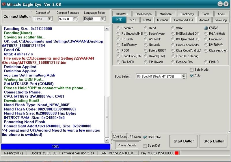

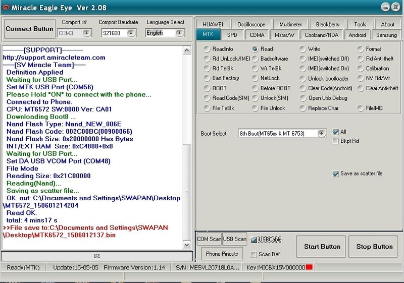

intex Aqua T3 Hang On Logo Solve By Format With Miracle Eagle Eye
intex Aqua T3 MT6572 Nand (New Flash Id)
Hang On Intex Logo Solve Just Only Format By
Miracle Eagle Eye+Miracle Key
No Need Full Flash/No Imei Loss/No Dead Risk
Br,

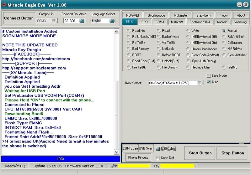

Smile Micromax-A110Q Hang On Canvas Logo Solve Only Format By Miracle Eagle Eye
Micromax-A110Q (MT-6583)

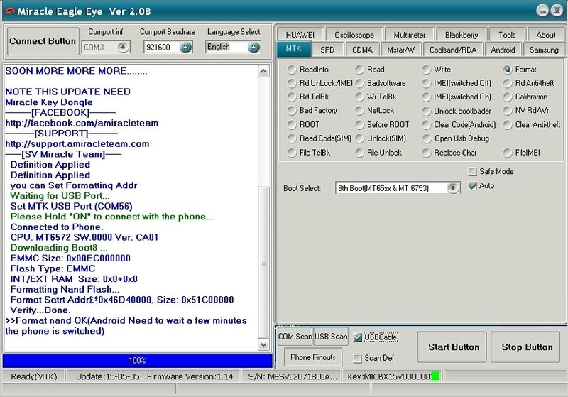

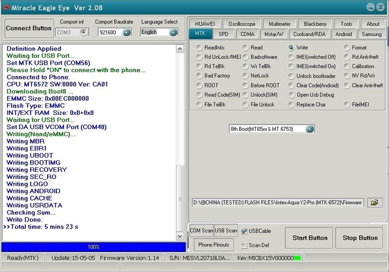

Smile Intex-Aqua-Y2-Pro the process com.android.phone has stopped Solve With Eagle Eye
Intex-Aqua-Y2-Pro MT-6572
Unfortunately,the process com.android.phone has stopped
Solve Just Flashing With
Miracle Eagle Eye+Key
Format
Flashing Done & Set Is Normal Mode
-:::BR:::-
