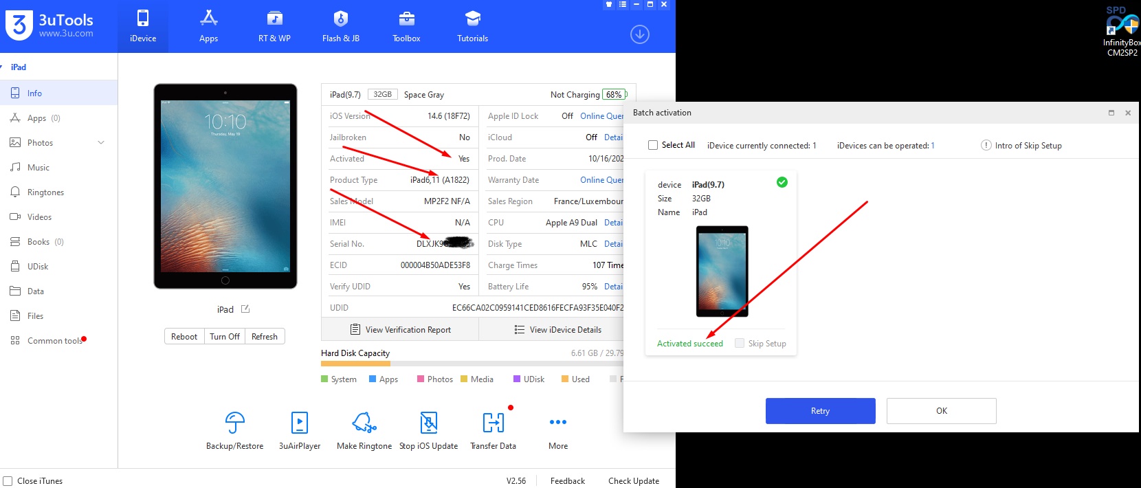

Hello All Friends
apple Now updates security patches
but it won't happen later
maybe there will be a solution soon
(But for now the best method
jailbreak and bypass method)
restore original address
then jailbreak and bypass
attached file is available
a thank you please.
And thanks Waseem Tech..
https://mega.nz/file/IhYDwK4D#fVFG37...TAAZf9K1UwchMI

If your ipad is gsm first change to wifi remove board id resistor
Device go to dfu mode
Write wifi model sn bt mac
Restore with wifi version
Done

If you remove resistor now you HAVE to change WiFi chip on air 2 up, the swap drivers dos not work anymore.
Best way is just to bypass iPads, can get all functions without messing about, Apple will start to block SN change as they have on mini 4s.

All ipad icloud remove change sn purple mode
ipad pro 1 9.7
ipad A1822/a1823 change wifi ic
ipad air A1567/a1566 change wifi ic
have All iapd sn number clean
activaiton all ok

Sorry A8 are blocked, yes can rite to all iPad but they won’t activate, even with clean details!
please cli,ck www.kilityok.com
change sn number
A8
for model: ipad air2/ipad mini4/ ipad mini 4 gsm change wifi ic/ipad 5 A1822/A1823 change wifi ic/ipad pro A1673/A1674 change wifi ic
ipad pro 10.5/ann gsm change wifi ic/ipad 12.9 1 generation and gsm chang wifi ic/ ipad pro 12.9 2 generation and gsm change wifi ic
all test ok ok ok ok ok

Clean New serial work. Thank you. ��

For a7 whats the solution … need to change WiFi ic too ?

A7 mini 2 4g add fuse, air 2 4g remove fuse and serial replace work. A7 not request wifi ic.

Do u have any pic of fuse ? Thanks

https://pasha4ur.org.ua/articles/dif...cloud-locked/8

But it will probably give activation error, you would have to rite new details.
Just use an iCloud bypass, will be allot quicker.

I mean even iPad WiFi only device can’t activate with new serial , is that bug fixed
Ex : iPad Air WiFi only
