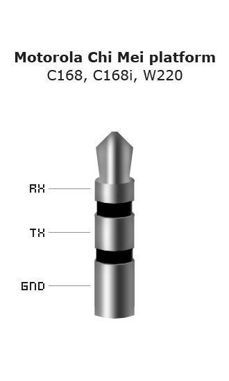

No Life Poster Join Date: Jun 2005 Location: rajabrothers communications Age: 43
Posts: 1,711
Member: 155773 Status: Offline Sonork: 1606514 Thanks Meter: 87 | what is this sc team ware is chi mei option and ware is imode option in new update i dont find chi mei option and why u remove i mode unlocking option look scr shoot. br raja |

Member: 300540 Status: Offline Thanks Meter: 103 | Smart Moto - Computer COM Ports Quote:
Pls in phone connection area select Computer COM Ports.... u wud have all u want ! GL&BR. | ||

Member: 182216 Status: Offline Thanks Meter: 24 | Quote:
" smart clip usb port " " computer com ports " to answer your question select " computer com ports" you will see i mode,and chi mei options......enjoy | |

Member: 13239 Status: Offline Thanks Meter: 3 | http://www.smart-clip.com/pinoutc115.png http://www.smart-clip.com/pinout_c168_c168i_w220.png Both pinout are equal but, Chi Mei code read works only with COM cable, not RJ45, so use old T191-Panasonic X60 cable. Regards |

Member: 13239 Status: Offline Thanks Meter: 3 | All is clear in support site . Chi Mei unlocking procedure 1. Connect* powered OFF phone to PC COM port. And look what this "*" says * Chi Mei models require to be connected to PC COM port via original COM data cable or using any COM port emulator I use, T191 RJ45 included with REDBOX, with REDBOX COM2RJ45 converter, or Universalbox, all work. T191 RJ45 cable included with Smart Clip, have different pinout (RJ45 pinout) and CAN NOT be used with UniBOX. Regards |
