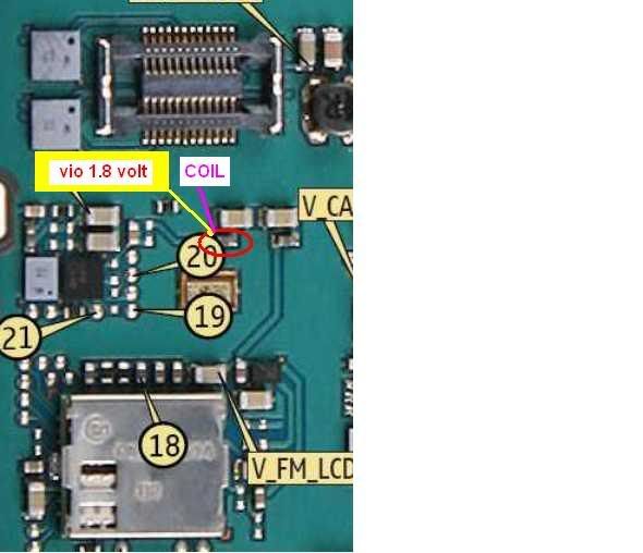

Old 09-26-2008, 07:07   #51 (permalink)
SHIJILFONOTLY's Avatar
Location: Kerala-India
Age: 46
Posts: 6,600
Member: 351924
Thanks Meter: 12,469
Nokia 6233 display white problem checking methode
NOKIA 6233 DISPLAY WHITE PROBLEM CHECKING METHODE HERE
1)CHECK OR CHANGE DISPLAY
2)RESOLDRING DISPLAY CONNECTOR
3)CHECK VIO 1.8 VOLT
THIS VIO VOLT MISSING?
A)CHECK RED MARKED COIL
B)JUST MAKE THIS JUMBER LIKE THIS PICTURE
4)CHECK FM LCD 2.8 Volt
THIS FM LCD 2.8 Volt MISSING?
A)CHECK THIS RED MARKED COIL
B)CHANGE THIS FM LCD 2.8 VOLT DRIVER
5)CHANGE DISPLAY EMI FILTER(2Nos)
6)LAST CHECK RAP3G REFLOW OR REBALL THIS CHIP
Regards
SHIJILFONOTLY
nokia repair master team
The Following 32 Users Say Thank You to SHIJILFONOTLY For This Useful Post:
